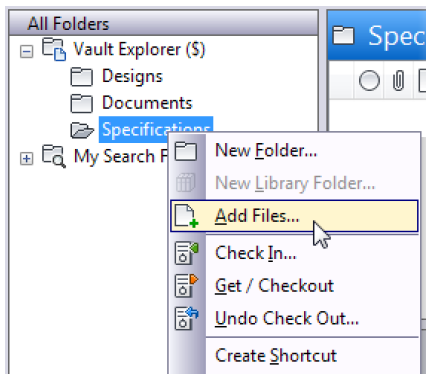

Add files to a vault using the Add Files command in the Vault client.
Right-click the vault folder to which the file will be added, and then select Add Files. A file browser is displayed.
Browse the local folders and select the files to add.
Click Open. The Add Files dialog box is displayed.
