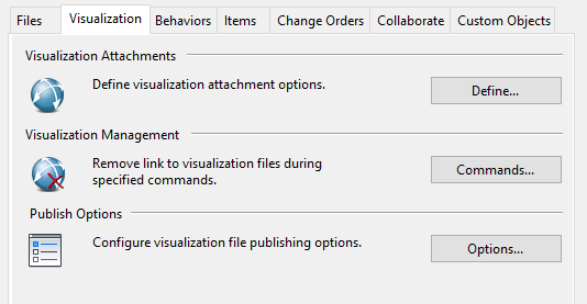

Access the Visualization Tab on the Vault Settings Dialog
- Click Tools > Administration > Vault Settings.
- In the Vault Settings dialog box, select the Visualization tab.
Visualization Attachments
You can enable or disable file attachments, specify where visualization attachments are published, and disable or enable the DWF warnings by clicking Define in the Visualization Attachments section.
- Click Define in the Visualization Attachment section to configure options for attaching visualization files.
Visualization Management
The Visualization Management options allow you to specify which commands break the link between a data file in the vault and its corresponding visualization file.
- Click Commands to specify which commands remove links to visualization files.
Publish Options
- Click Options to configure the publishing settings for visualization files.
