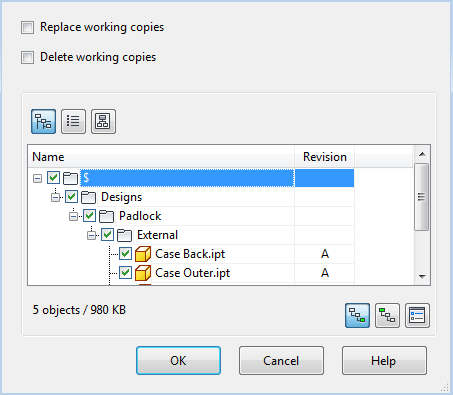

In the Undo Check Out dialog box, specify if you want to replace the local file with the version currently stored in the vault and whether or not to delete the working copy of the file. Select Replace working copies to reset any changes that were made to the working copy of the file.
Undo Check Out Dialog for Multiple Files in Vault Professional
Click the the dependents
icon to include children of the selected file. Click the parents
icon to include parents of the selected file. Click OK.
