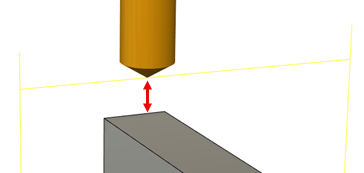

  8. Specify a Safe Distance to keep the tool away from the part's surfaces during link moves.
    safe distance between the tool and a surface during a link move
