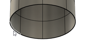

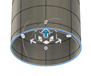

  1. Translate the bottom of the bottle downwards by 2.5 mm to create a height face and scale it inwards by a factor of 0.85.
    1. Click Form > Modify > Edit Form edit form.
    2. In the canvas, double-click the circular edge at the bottom of the bottle.
      circular edge

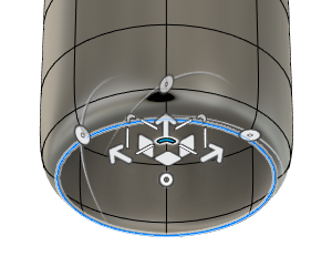

    3. Hold the Alt key and click and drag translate y on the manipulator to translate downwards by -2.5 mm.
      translate
    4. Click and drag scale zx on the manipulator to scale inwards by a factor of 0.85.
      scale
    5. Click a blank area on the canvas.

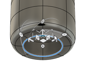

  2. Scale the bottom of the bottle inwards by a factor of 0.7 and again by a factor of 0.85 to create two flat faces.
    1. Double-click the circular edge at the bottom of the bottle.
    2. Hold the Alt key and click and drag scale zx on the manipulator to scale inwards by a factor of 0.7.
      scale
    3. Click a blank area of the canvas.
    4. Double-click the circular edge at the bottom of the bottle.
    5. Hold the Alt key and click and drag scale zx on the manipulator to scale inwards by a factor of 0.85.
      scale
    6. Click a blank area of the canvas.

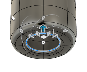

  3. Translate the opening of the bottom of the bottle upwards by 2.5 mm to create a circular indent.
    2. Hold the Alt key and click and drag translate y on the manipulator to translate upwards by 2.5 mm.
      translate y

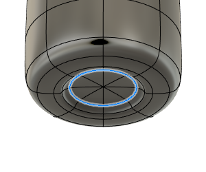

  4. Fill the hole at the bottom of the bottle to make it watertight.
    1. Click Form > Modify > Fill Hole fill hole.
    2. Make sure the circular edge at the bottom of the bottle is selected. If the edge is not selected, double-click it.
    3. In the Fill Hole dialog, select a Fill Hole Mode of Collapse.
      fill hole
    4. Click OK.

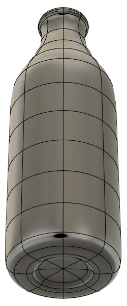

Activity 3 summary
In this activity, you rounded off the corner of the bottom of the bottle, created a flat bottom, created a circular indent, and then filled the hole to make the bottle watertight.
activity 3 complete
Water bottle with closed bottom
