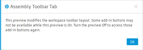

Assembly User Interface Changes (Insiders Only)
There are changes to the assembly workflow currently being tested by those in the Insider program. These changes can affect add-ins. Both when you're writing and using them. If you have this feature enabled and are having trouble with an add-in, like missing commands or bad behavior, try turning it off.If you're writing add-ins that are impacted, please let your users know to turn off the preview feature. You'll need to wait for the next release for more information about how to modify your add-in to be compatible with these new changes. You'll also want to join the Insider program so you can do some early testing and have your add-in ready to go when the new functionality is released.

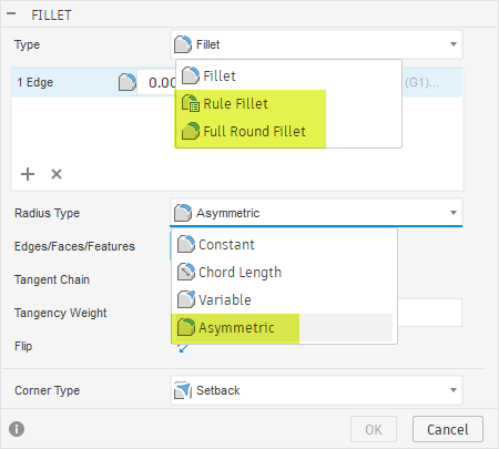

Fillet Feature Enhancements
Two significant enhancements have been made to the API for the fillet feature. Using the API, you can now create asymmetric and rule fillets. The previous release added an API to support full round fillets. With these enhancements, the API now fully supports the fillet feature. -

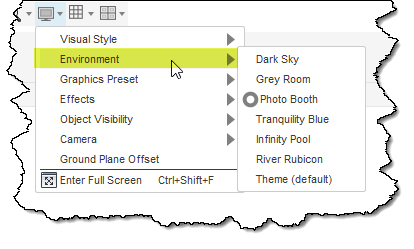

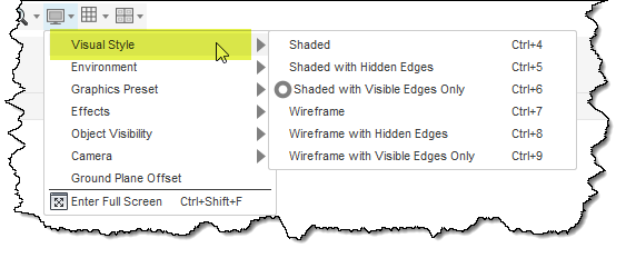

Full API Support for the Display Settings
There are many related settings available in the Navigation toolbar in the "Display Settings" drop-down. Some of these have been supported by the API for a long time, like Camera and Visual Style, but many have never been available in the API. Below is a list of the different settings and links to the API objects or functions that now support them. For completeness, this shows how all of them are accessed, regardless of whether they're new in this release.Set how the model is rendered using the Viewport.visualStyle property. This has been in the API for a long time.
New in this release is the ability to get and set which environment is used to render the view. Use the new Application.lightingEnvironment property.

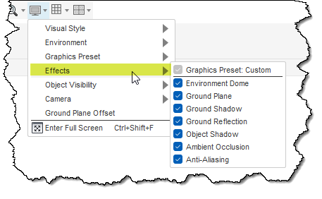

Released earlier this year is the ability to get and set the various canvas effects. They are accessed through the GraphicsPreferences.canvasEffects property. The GraphicsPreferences object is accessed using
Application.preferences.graphicsPreferences.

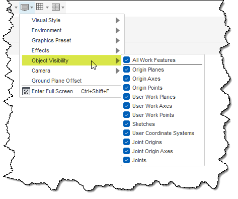

New in this release is the ability to get and set which objects are visible. This is done using the ObjectVisibility object, which is obtained using the Design.objectVisibility property.

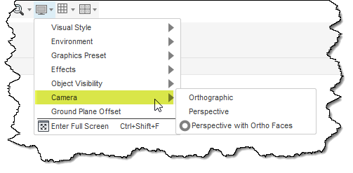

Support for the Camera settings has been available for a long time by using the Camera object. You get the Camera object from a Viewport using the Viewport.camera property.

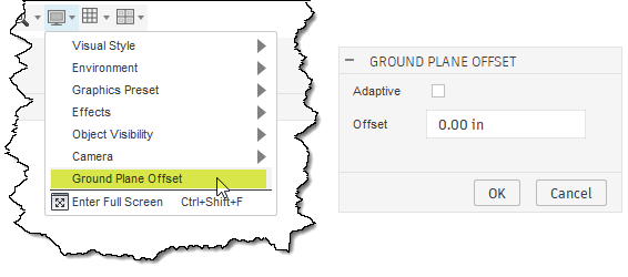

Support for the ground plane offset is new in this release. This is done through two new properties, Design.isAdaptiveGroundPlane and Design.setGroundPlaneOffset. Setting the offset to be adaptive allows the ground plane to automatically adjust so it is always at the bottom of the model. Setting the offset turns off the adaptive setting and moves the ground plane from the bottom of the model.

| Design.isAdaptiveGroundPlane | Gets and sets if the position of the ground plane for this design is adaptive. If true, the ground plane will automatically move to be just below the model. The orientation of the ground plane is always normal to the "up" direction as defined by the view cube. |
| Design.objectVisibility | Returns the ObjectVisibility object associated with this design which controls which objects are displayed in the graphics window. This is the equivalent of the "Object Visibility" settings in the Display Settings drop-down in the navigation toolbar at the bottom of the Fusion graphics window. |
| Design.setGroundPlaneOffset | Sets the offset of the ground plane. If the isAdpativeGroundPlane property is true, setting the offset will change isAdaptiveGroundPlane to false. The offset value is an offset relative to the current position of the ground plane. One example of how this method can be used is to set the isAdaptiveGroundPlane property to true, which will position the ground plane at the bottom of the part. By doing this, you know the current position of the ground plane. Then calling this method with a value of -2.0 will reposition the ground plane 2 cm below the part. If you called this method again with a value of -1.0 the ground plane will be moved an additional 1 cm away from the geometry, since this is defining an offset relative to the current position.  |

| FilletEdgeSetInputs.addAsymmetricRadiusEdgeSet | Adds an asymmetric fillet edge set to the fillet feature input. Some settings are initialized with a default value and can be set by modifying properties on the returned AsymmetricFilletEdgeSetInput object. |
| FilletEdgeSets.addAsymmetricRadiusEdgeSet | Adds an asymmetric fillet edge set to the fillet feature. To use this method, you need to position the timeline marker to immediately before this feature. This can be accomplished using the following code: thisFeature.timelineObject.rollTo(True)  |
| FilletFeature.ruleFilletSettings | Gets the RuleFilletSettings object for the rule fillet. This is valid only when the filletFeatureType is FilletFeatureTypes.RuleFilletFeatureType, otherwise this returns null.  |
| FilletFeatures.addRuleFillet | Creates a new rule fillet feature. |
| FilletFeatures.createRuleFilletInput | Creates a RuleFilletFeatureInput object. Use properties and methods on this object to define the fillet you want to create and then use the addRuleFillet method, passing in the RuleFilletFeatureInput object. |
