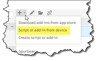

Linking Scripts and Add-Ins
Fusion also supports using a script or add-in that can exist anywhere on your computer. This is done by adding a "link" to the script or add-in folder. You create a link using the "Script or add-in from device" option in the drop-down of the "+" plus command at the top of the list section, as shown below. When running the command, you can browse for any script or add-in folder on your computer. Fusion will remember it and add it to the list of scripts and add-ins. When a linked script or add-in is selected in the list, you can use the "Unlink" command at the top of the list section of the dialog to remove the script or add-in from the list and have Fusion forget about it. Unlinking does NOT delete the folder but only causes Fusion to forget about the script or add-in.

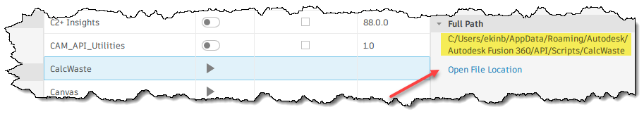

To permanently remove a script or add-in, delete it from your computer. If it was installed on Windows using an installer, it's best to uninstall it using the uninstaller, if it has one. The installed app will often be in the Start menu where you will find a command to uninstall it or right-clicking on the app will show an "Uninstall" command. You can also use the "App and Features" tool in Window 10 or the "Installed Apps" in Windows 11 where the installed apps should be listed and you can choose to uninstall it.If an installer was not used, or you're using a Mac, you can delete the folder containing the add-in by browsing to it using Window's File Explorer or Mac's Finder and deleting or moving it to the trash.
To determine the location of a script or add-in, select it in the list and it's path is shown in the right-hand section of the dialog with other details about the selected script or add-in. You can also click the "Open File Location" link to open that folder in Window's File Explorer or Mac's Finder.

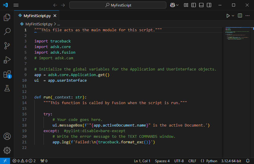

The new script will now be shown in the list. To edit it, use the "Edit in code editor" command from the toolbar at the top of the list section or the context menu, as shown below.
You can now use VS Code to edit your program. For this simple example, edit the text for the messageBox to any message you would like, such as what's shown below, and save the changes.
Congratulations, you have just written your first script. To run your script, run the Scripts and Add-Ins command, find your script in the list, and click the
icon beside it.
The script will run and do whatever it is programmed to do. In this case it will display the message box shown below.
