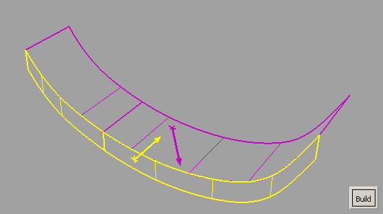

Freeform blend lets you create a fillet between surface curves (surface boundaries, trim edges, Isoparametric curves or Curves-on-surface).
In other words, you use surface curves on the two sets of surfaces to define the contact lines at the ends of the fillet.
You can also select free curves. If a contact line is made up entirely of free curves, that side reverts to G0 Position continuity. As well, Edge align is not possible on that side. If a contact line is made up of both free curves and surface curves, then up to G1 Tangent continuity is allowed on that side. You can only attempt Edge align for the surface curve sections.
The first set of curves is highlighted in purple.
If Chain Pick is turned on in the option window, selecting the boundary of one surface will also select all other boundaries that are tangent continuous with it.
The second set of curves is highlighted in yellow.

Use the options in the Flow Control section, or click the labels on the model, to control how the blend surface(s) edges (in the V direction) meet up with the edges of the boundary surfaces. You can adjust the alignment of the start, end, and (if more than one blend surface) interior edges.
