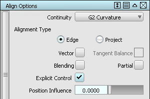

Align
The equivalent of the ICEM Match tool is Object EditAlign. This tool creates a G0, G1, G2 or G3 relationship between two surfaces (or two curves) and maintains that relationship as CVs are moved.
