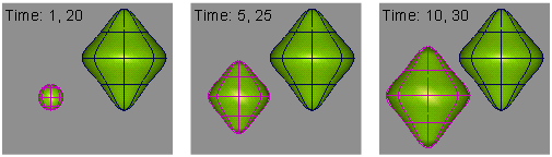

Example
In this example, a sphere is used to create an interpolation animation where the sphere takes on a diamond shape through 10 keyframes, then reverts to its original shape through another 10 keyframes, and back to the diamond in another 10 keyframes.
Place two spheres
  1. Choose Surfaces > Primitives > Sphere and place a sphere in the Left window at -5,0,0.
  2. Place another sphere at 3,0.0. Both of these pieces of geometry are identical in topology.
Scale and move the spheres
  1. With the second sphere active, choose Transform > Scale and type 4 to scale the sphere to a value of 4 units.
  2. Choose ObjectDisplay > Control and make sure the CVs is toggled ON (indicated by a check mark). Press GO.
  3. Choose Pick > Nothing to ensure that no geometry is active, then choose Pick > Point Types > CV and using the bounding box technique, select only the first row of CVs along the top of the second sphere.
  4. When the CVs are active, choose Transform > Move and use the to move these CVs upwards along the Z-axis to elongate the top of the sphere into a pointed shape.
  5. Choose Pick > Nothing to ensure that no geometry is active. Select the last row of CVs along the bottom of the second sphere.
  6. When the CVs are active, choose Transform > Move and use the to move these CVs down the Z-axis to elongate the bottom of the sphere into a pointed shape.
  7. Choose Pick > Nothing to ensure that no geometry is active. Select the middle row of CVs of the second sphere.
  8. When the CVs are active, choose Transform > Scale and use the to scale these CVs up to create a bulge in the middle section of the shape so that it resembles the diamond shape shown in the diagram at the right.
    The original sphere defines the start shape and the modified sphere defines the final interpolated shape. Although only two shapes are being used in this example, several interpolated shapes could be used.
Set a keyshape
  1. Choose Pick > Nothing to ensure that no geometry is active, then choose Animation > Tools > Set Key Shape. The system prompts:
    Pick the curves or surfaces which are to change shape. Press GO when ready.
  2. Click the first sphere. Once selected, it is highlighted to indicate the object whose shape will be changing.
    Note:
    If you were including other geometry animation, you would continue to select geometry in response to the prompt.
    A small GO icon appears in the lower right corner of the active window, and the system continues to prompt:
  3. Click the GO icon to continue, and the system prompts:
    Enter a key frame value(s) for the picked item(s) current shape (last frame set is 0):
  4. Type 1 followed by a space, then type 20 and press (Windows) or (Mac).
    This indicates that the shape of the initial sphere is to be used for keyframes 1 and 20. The system prompts:
    Pick the curve or surface to match.
  5. Click the second sphere. The original geometry changes shape to match the selected geometry.
    If the surface you select to match does not match the topology of the surface you select to change shape, an error message is displayed and the system prompts:
    If the topology of the selected surfaces match, the system prompts:
    Enter a key frame value(s) for this shape (last frame set is 20):
  6. Type 10 followed by a space, then type 30 and press (Windows) or (Mac).
    This indicates that the shape of the manipulated sphere is to be used for keyframes 10 and 30.
  7. Choose Animation > Show > Playback to view the interpolation animation.
    During playback, the initial sphere shape interpolates into the shape of the manipulated sphere through frames 1 to 10. It then interpolates back to the original shape through frames 10 to 20, then back to the manipulated shape through frames 20 to 30.
