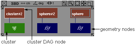

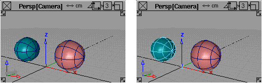

  1. To create a cluster, first create two primitive spheres (Surfaces > Primitives > Sphere).
  2. Pick the spheres using Pick > Object, or pick some of the CVs of each of the spheres.
  3. Choose Animation > Create > Cluster.
    Note:
    Picking an object puts all of its CVs in the cluster.
  4. Open the SBD window (Utilities > SBD > Open SBD Window) to verify that the cluster has been created. It is displayed as a node with a DAG node above it. The DAG node box is highlighted and the cluster (an icon of a cluster of grapes) is in a box directly under it.
    The geometry node (blue node) from which the cluster was assembled has an additional blue box placed around the geometry box indicating that some of the geometry is in a cluster that is picked. If the cluster is unpicked, the blue box around the geometry box disappears.
The new cluster DAG node will be the only item on the pick list after the operation is complete.

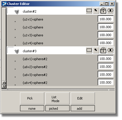

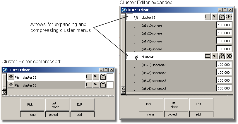

Use Animation > Editors > Clusters to allow you to add or remove cluster members, move or copy members between clusters, modify percentage effects of members, toggle a cluster’s percentage effect type between joint or leaf DAG nodes, or reorder the clusters to set the order in which the cluster transforms will be applied.
To use the Cluster Editor window
When the Cluster Editor is opened, all clusters specified by the list mode (picked by default or clusters with an active ancestor in the DAG) will be loaded into the Cluster Editor. The clusters are loaded compressed (that is, the members are not visible and are listed according to their global ordering).
Name field
The name of a cluster can be changed by double-clicking the name field.
Cluster Editor buttons
The expand/compress cluster buttons let you expand a cluster to view each of its members, or to compress the cluster to show just the name of the cluster. When a cluster is expanded, members are displayed in the following order: first DAG nodes alphabetically by name, then surface CVs, and curve CVs.
When a cluster is expanded to show its members, a member may be a DAG node. In this case, the DAG node has an expand member arrow to the left of its name. If this arrow is selected, the DAG node is expanded to show everything below it (for example, other grouped DAG nodes, or geometry CVs). If all the siblings of a cluster member are in the cluster (for example, all the CVs of an object are in the cluster), then the member has a compress arrow to the right of its name. If this arrow is selected, the parent DAG node replaces the member and its siblings in the cluster.
The percentage effect type buttons toggle the percentage effect type of the cluster. The joint percentage effect type tells the cluster to apply its percentage effects to the transformations in the first skeleton joint node that is above the cluster. Leaf node percentage effects tells the cluster to use the transformations in the DAG node directly above it.
The pick-in-modeler button updates the pick state in the modeler for the cluster and its members.
The lock-in-list button ensures that this cluster will remain in the Cluster Editor even if the cluster is unpicked in the modeler.
This is useful in the List Mode > picked mode, where the Cluster Editor will continually update to reflect the currently selected items, and so the cluster would otherwise disappear from the editor if it was unpicked.
The multi/exclusive button lets you toggle the cluster membership type. An exclusive cluster cannot contain cluster members that are in any other cluster.
Multi-clusters can contain members that are in other multi-clusters. An exclusive cluster can always be made multi; however, a multi-cluster may only be set to exclusive if none of its members belong to any other cluster.

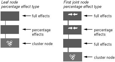

Cluster percentage effect types
By changing the cluster percentage effect type you control which DAG node in the hierarchy above the cluster has the percentages applied to its transformations.
If the leaf type is chosen, the transformations of the DAG node that is directly above the cluster are weighted by the cluster percentages of the cluster. All other DAG nodes in the hierarchy have their full transformations applied.
When the joint type is chosen, the percentage effects are applied only to the first joint DAG node above the cluster. All other DAG nodes in the hierarchy both above and below the first joint node have their full transformation applied to the cluster members.
Joint type percentage effects have an additional feature: the percentage effects are applied only to the difference between the current transformations in the joint and the transformation that was in the joint node when the joint type cluster was created.
If a cluster has its percentage effects type set to joint and there is no joint node above the cluster, it behaves as if its percentage effects type were set to leaf.
For example, suppose that you have a simple chain skeleton with a leaf type cluster under its bottom joint and that the bottom joint’s transformation is a simple rotation of 60 degrees around the Y axis. If you toggle the cluster percentage effect type to joint, the cluster "memorizes" the Y axis rotation.
Now, suppose that you rotate the joint further around the Y axis to 80 degrees. A member with a percentage effect of 50% inherits the original transformation of 60 degrees plus half of the difference between 60 and 80 degrees, resulting in a net transformation of 70 degrees. A member with a percentage effect of 25% rotates by 65% degrees; and a member with a percentage effect of -25% rotates by 55 degrees.
For leaf type percentage effects the original transformation is always assumed to be the identity; that is, the X,Y, Z translates are 0, the X,Y, Z rotates are 0, and the X,Y, Z scales are 1. Continuing the example, if after rotating to 80 degrees you toggled the cluster percentage effect type back to leaf node, the members affected by the cluster would shift. A member with a percentage effect of 50% would now take half of 80 degrees, giving a net transformation of 40 degrees; a member with 25% would rotate by 20 degrees; and a member with -25% would rotate -20 degrees.

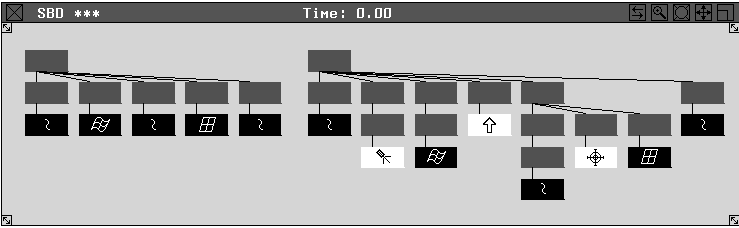

The following illustration shows what percentages look like in the SBD window.

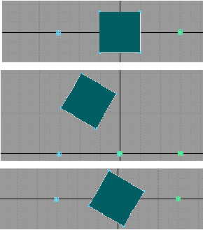

Multi-cluster transformations
All clusters in the model have a global ordering. It defines the order in which the cluster transformations are applied to a CV that is in more than one cluster (a multi-cluster). If the multi-clusters contain only translation transformations, the order does not matter.
However if the multi-clusters contain rotation or scaling transformations, then the actual position of the CV will depend on the order of the clusters that it belongs to.
The diagrams illustrate this point. In the first diagram, a plane is created and placed at the origin. The plane is then put into two multi-clusters, one with its pivot to the left of the plane, and the other with its pivot to the right of the plane.
The second and third diagrams show two different effects when the clusters are each rotated 60 degrees. In the second diagram, the cluster with its pivot to the left of the plane is applied first, whereas in the other diagram, the cluster with its pivot to the right of the plane is applied first.
Global ordering is useful to achieve layered cluster effects. For example, suppose that you want to animate a slug by flowing it along a motion path (see Animation > Tools > Set Motion with the FLOW option), and then animate its eyeballs on top of its eyestalks using a cluster deformation. In that case, the cluster transformation affecting the eyestalks should occur before the cluster transformation affecting the whole body. If you did Animation > Tools > Set motion before the clusters for the eyestalks were created, then the cluster transformations would be applied in the wrong order, and the animation would appear incorrect. Reordering these clusters so that the deformation cluster for the eye stalks appears before the flow clusters will correct the situation.
The order in which clusters are applied to a model can be changed by changing their order in the Cluster Editor.

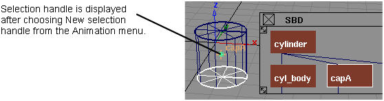

  1. Create an object.
  2. Select the object or DAG node that you want to add a selection handle to.
  3. Choose Animation > Create > New Selection Handle.
    A pale orange cross and the node name are displayed at the object’s or node’s rotate pivot (the cross looks like the one in the icon). If the selection handle is inactive, the cross and node name become red.
    Tip:
    If you are having difficulty seeing the selection handle that you created, you can move it away from the object or node using Animation > Tools > Move Selection Handle or Transform > Local > Set Pivot and opening its options.
Example
Using a cylinder as an example, you can place selection handles on the component nodes and use them to easily activate the components or the cylinder as a whole. To add a selection handle:
  1. Select a component of the cylinder in the SBD window.
  2. Choose Animation > Create > New Selection Handle. A new handle is displayed at the rotate pivot.
    Continue to add new handles as you need them.
    Choose Windows > Information > Information Window for more details on the selection handles you have just inserted into your model.
    To delete a selection handle simple select the selection handle and then Delete > Animation > Delete Selection Handles.

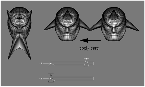

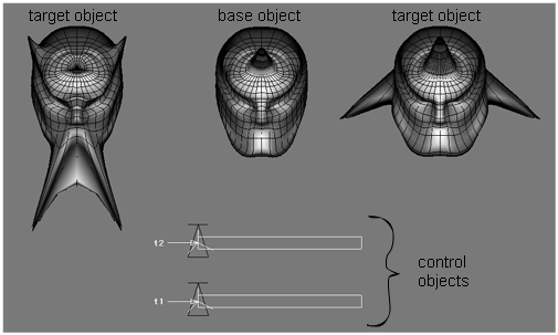

ShapeShifter
ShapeShifter interpolations are created by placing the CVs of the base object into clusters, and then providing a method for the amount of transformation to be selected. ShapeShifter interpolations also allow various target shapes to be mixed together.

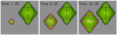

Example
In this example, a sphere is used to create an interpolation animation where the sphere takes on a diamond shape through 10 keyframes, then reverts to its original shape through another 10 keyframes, and back to the diamond in another 10 keyframes.
Place two spheres
  1. Choose Surfaces > Primitives > Sphere and place a sphere in the Left window at -5,0,0.
  2. Place another sphere at 3,0.0. Both of these pieces of geometry are identical in topology.
Scale and move the spheres
  1. With the second sphere active, choose Transform > Scale and type 4 to scale the sphere to a value of 4 units.
  2. Choose ObjectDisplay > Control and make sure the CVs is toggled ON (indicated by a check mark). Press GO.
  3. Pick nothing to ensure that no geometry is active, then choose Pick > Point Types > CV and using the bounding box technique, select only the first row of CVs along the top of the second sphere.
  4. When the CVs are active, choose Transform > Move and use the to move these CVs upwards along the Z-axis to elongate the top of the sphere into a pointed shape.

Set a keyshape
  1. Pick nothing to ensure that no geometry is active, then choose Animation > Tools > Set key shape. The system prompts:
    Pick the curves or surfaces which are to change shape. Press GO when ready.
  2. Select the first sphere. Once selected, it is highlighted to indicate the object whose shape will be changing.
    If you were including other geometry animation, you would continue to select geometry in response to the prompt.
    A small GO icon appears in the lower right corner of the active window, and the system continues to prompt:
  3. Click the GO icon to continue, and the system prompts:
    Enter a key frame value(s) for the picked item(s) current shape (last frame set is 0):
  4. Type 1 followed by a space, then type 20 and press Enter.
    This indicates that the shape of the initial sphere is to be used for keyframes 1 and 20. The system prompts:
    Pick the curve or surface to match.
  5. Select the second sphere. The original geometry changes shape to match the selected geometry.
    If the surface you select to match does not match the topology of the surface you select to change shape, an error message is displayed and the system prompts:
    If the topology of the selected surfaces match, the system prompts:
    Enter a key frame value(s) for this shape (last frame set is 20):
  6. Type 10 followed by a space, then type 30 and press Enter.
    This indicates that the shape of the manipulated sphere is to be used for keyframes 10 and 30.
  7. Choose Animation > Show > Playback to view the interpolation animation.
    During playback, the initial sphere shape interpolates into the shape of the manipulated sphere through frames 1 to 10. It then interpolates back to the original shape through frames 10 to 20, then back to the manipulated shape through frames 20 to 30.

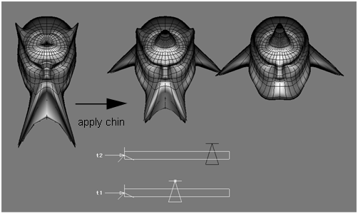

With ShapeShifter, an unlimited number of expressions and forms can be combined to transform objects into a variety of shapes, as well as mixing facial expressions together.
ShapeShifter transforms (or “morphs”) one shape into another by transforming CVs using clusters and expressions. This lets you select how much of the interpolation should be applied at any particular time, as well as mix several different target shapes together. Because clusters are used, the underlying geometry can be polygonal or NURBS. Source and target objects can also be hierarchical, as long as the hierarchies match.
ShapeShifter greatly simplifies complex facial animation. For example, given a base (or neutral) face, and other faces that represent a smile and frown, you can create a face which is 75% smiling and 50% frowning and control the timing of the interpolation between the various targets.
The interpolation is done by determining the translation which will make a CV in the source object move to the corresponding CV in the destination object. Therefore the two objects must share the same topology (that is, they must have the same number of CVs in both u and v).
The interaction is simple — for each target, a “control” object is created. The X translation of this object determines the amount of transition from the base to the target object and, of course, can be animated. For example, to have the neutral face ease into a smiling face over two seconds, you simply move the control object to the left of the slider, set a keyframe at 0, then move the control object to the far right and set another keyframe at 60. Set the animation interpolation in the Action Window on the control object’s X_translation channel (or use an expression) and you’re ready to go.
Example
The following example shows how ShapeShifter is used to combine features from two separate head expressions.
The middle head combines the features from the other two heads. The head on the left has been manipulated to exaggerate the chin and horns of a little devil. The head on the right has a pointier head, as well as some devilishly handsome ears.
Moving the control object of the top slider causes the middle head to acquire some of the features of the head on the right. Notice how the middle head is also pointier, and has begun to sprout its own pair of ears. The amount of shape-shifting can be controlled by the position of the slider.
As you start to move the control object of the bottom slider, notice how the middle head begins to acquire some of the characteristics of the left head as well as retaining the effects of the right head.
Note:
The source and destination objects must share the same topology (they must have the same number of CVs in both U and V). The interpolation is done by determining the translation which makes the CV in the source object move to the corresponding CV in the destination object.
To set the options:
  1. Choose Animation > Tools > Set Key Shape then click ShapeShifter in the Interpolation section of the option box.
  2. At the prompt for the source object, select the head at the left.
  3. At the prompt for the target object, select the middle head.
  4. At the prompt for the control object name, type chin.
    A DAG node containing 3 clusters and a DAG node for the control object are created.
    Note:
    If Create control geometry is checked, a triangular object is included in the control object DAG node.
    Note:
    If Create slider geometry is checked, a DAG node containing the geometry representing a slider bar and a locator object for its name are also created. This last object is created in a templated state.
Hierarchical ShapeShifter interpolations
ShapeShifter interpolations can also be created between objects consisting of many grouped geometry nodes.
For grouped objects, the Shape Center is created as follows:
The following is an example of the SBD view with two diverse hierarchies, which can still be used for ShapeShifter interpolations. Geometry nodes are matched up going from left to right through each object.

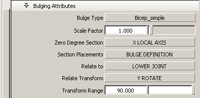

Character Builder Frame Types
Modify — modifies the way CVs on a frame are currently attached. This is convenient when you change some of the options in the Deformation Control window and want the attach you already performed to reflect the new settings. This operation is essentially identical to doing a Detach followed by an Attach.
Set Attributes — stores the currently displayed character joint and bulging attributes on a picked joint.
If Hierarchy Depth is set to BELOW or PARTIAL BELOW, attributes are also stored on all the joints below the picked joint according to the Hierarchy Depth setting.
Load Attributes — updates the Deformation Control window with the values previously set on a picked joint.
Remove Attributes — removes any previously set attributes from the selected joints.

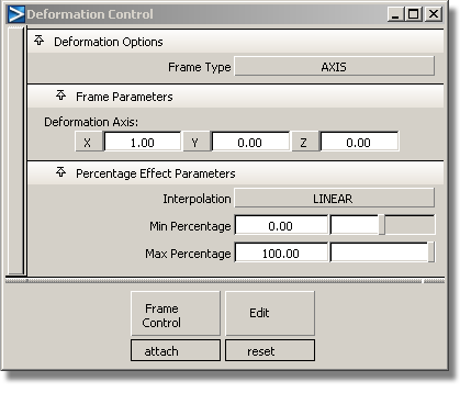

Axis deformation Frame Type
An AXIS deformation is the simplest of the deformations to use. It creates a single cluster to achieve the deformation effect. The most obvious use of AXIS deformation is for bend, twist, or tapering operations.
The system computes the percentage effects to be used on the CV members of the cluster based on their distance from a plane. The position of this plane is defined by the deformation AXIS parameters.
When Frame Type is set to AXIS, the Deformation Control window updates as shown in the following.
Frame Parameters
Deformation Axis
The Deformation Axis parameters are used to specify the direction in which the percentage effects will change.
Click and drag at the bottom of these sliders to select a value, or click to type a new value then press Enter.
The interpolation distance is computed as the world space distance between the object’s CV and a plane that is normal to the deformation axis. The origin of this plane is computed by projecting a bounding box in the axis direction and finding the point at which there will be 0% effect. The easiest way to picture this is to imagine a cylinder as the deforming object. The deformation axis lies in the direction of the long axis of the cylinder. The origin will be at the center of the bottom of the cylinder when the percentage range is 0.00 to 100.00. Each of the DeformationAxis parameters are editable and any deformation axis can be specified.
Percentage Effect Parameters
The Percentage Effect Parameters for Interpolation and the Min/Max Percentage values are the same for the AXIS and CURVE frame types.
Interpolation
Determines how the percentage effect will be distributed among members of CV clusters. Click to the right of the Interpolation heading to display the following menu.
LINEAR — the percentage effect on members of the clusters is distributed based on a linear interpolation between the Min and Max Percentage values.
EXPONENTIAL — the percentage effect on members of the clusters is distributed exponentially between the Min and Max Percentage values.
SINE — the percentage effect on members of the clusters is distributed according to a sine curve interpolation between the Min and Max Percentage values.
The following diagram shows these three interpolation types.
Min/ Max Percentage
Determines the range of percentage effects that the CVs in the clusters can have. These values can be positive or negative, including a value of 0.00. Although the slider controls have a range of -100.00 through 100.00, values outside of this range can be typed directly into the parameter fields. Reversing the values so the MinPercentage is greater than Max Percentage effectively reverses the direction of the curves shown in the previous illustration.

  4. Choose Animation > Editors > Deformation control to display the Deformation Control window and make sure that the Frame Type parameter is set to AXIS. All other default settings should be in effect.
  5. Click the Frame Control button at the bottom of the window and choose Attach from the menu. A Go icon is displayed and the system prompts:
    Pick uninstanced surface(s) to deform, then GO.
  6. Select the surfaces you want to deform. Once selected, the surfaces are highlighted.
  7. When all the surfaces you want to deform are selected, click GO. The system responds with a prompt indicating that it is creating an axis deformation.
    Once the prompt clears, the axis deformation frame has been attached to the active objects (the cylinder in this example).

    Clusters can also be selected directly in the SBD window using either Pick > Object or Animation > Pick > Cluster.
  4. Choose Delete > Delete Active to delete the active cluster, returning the model to its original state.

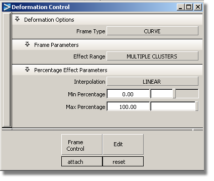

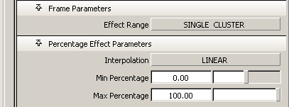

When a CURVE Frame Type is selected, the Deformation Control window updates as shown in the following.
Frame Parameters
Effect Range
Click to the right of the heading to display the Effect Range menu.
MULTIPLE CLUSTERS — each handle affects all CVs on the object’s surface.
The handle closest to a CV has the most effect, with a diminishing effect from handles that are farther away from the CV.
SINGLE CLUSTER — ensures that the CVs on the object’s surface are only affected by the one handle which is closest to them.
Interpolation
Determines how the percentage effect is distributed among members of CV clusters.
The Interpolation options are the same as for the AXISFrame Type.
The CV closest to the frame CV gets the maximum percentage. The CV furthest from the frame CV gets the minimum percentage. If the minimum is 0, the furthest CV is not clustered.

  5. Choose Animation > Editors > Deformation Control to display the Deformation Control window and make sure the Frame Type is set to CURVE in the menu. All other default settings should be in effect:
  6. Click the Frame Control button at the bottom of the window and choose Attach from the menu. A Go icon is displayed and the system prompts:
  7. Select the surfaces you want to deform. Once selected, the surfaces are highlighted.
  8. When all the surfaces you want to deform are selected, click Go. The system prompts:
    Select curve(s) to use as frame, then GO
    Select the curves you want to use as the frames, (the duplicated isoparametric curve in this case). Once selected, the curves are highlighted.

Detaching the Curve frame
  1. Pick nothing to ensure that no geometry is active.
  2. Click the Frame Control button at the bottom of the Deformation Control window and choose Detach from the menu.
    The system prompts:
    Pick frame(s) to detach, the GO
  3. Select the CURVE frames to be detached from their respective objects. As a CURVE frame is selected, it is highlighted.
  4. When the frames you want to detach are selected, click Go to proceed with the Detach operation.
  5. Once Go is clicked, the selected frames are detached from the objects to which they were attached and the objects themselves return to their original shape. The original CURVE Frame curve is retained.
More to try
  1. Leave the CURVE frame curve in its current location off to the side of the cylinder surface and reattach it to the cylinder again.
  2. Make sure that no geometry is active, choose Animation > Pick > Cluster and select a CV attached to the second handle from the top of the CURVE frame curve.
    Once the cluster is selected, the handle is highlighted as well as all CVs that this handle controls.
  3. Choose Transform > Scale and use the to scale the cluster up to deform the surface.
    Notice how the percentage effect of the scale ranges from a Min Percentage of 0 to 100 around the periphery of the cylinder because all CVs are no longer an equal distance from the frame curve.
  4. Detach the CURVE frame from the cylinder, returning the cylinder to its original shape.
  5. Attach the CURVE frame to the cylinder again.
  6. Select individual handles and use Transform > Move to deform the surface. Experiment with Transform > Rotate and Transform > Non-p Scale.
Percentage
Determines the percentage of effect that all CVs in the clusters will have. This value can be positive or negative. A value of 0.00 will result in the deformation frame having no effect at all.

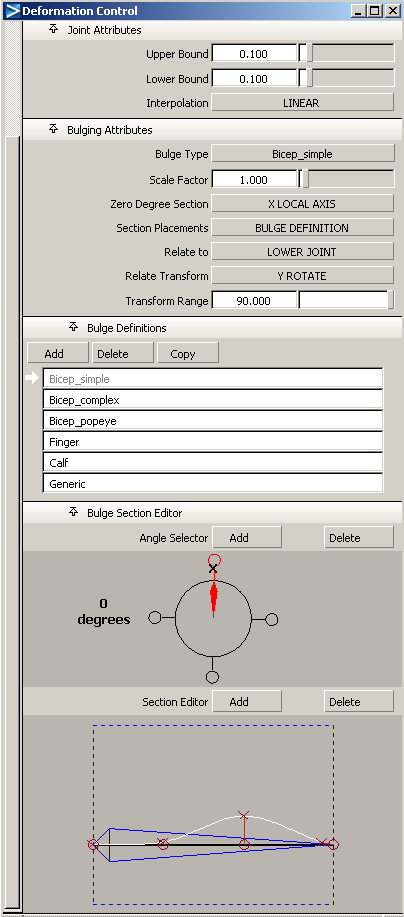

Joint Attributes
These options let you control how smoothly geometry CVs around a joint will bend and tuck at that joint.
Upper and Lower Bounds
The Upper Bound and Lower Bound values provide a way of specifying how much the transformations at the joint will affect the CVs within those bounds. In other words, these bounds define the region around the skeleton joint where the bending and tucking will occur.
The Upper Bound defines a percentage along the bone from the current joint to its parent joint.
The Lower Bound defines a percentage along each of the bones from the current joint to each child joint.
CVs at the upper bound receive 0% of the transformation (full effects of the upper bone) and CVs at the lower bound receive 100% (full effects of the lower bone). The percentages of the CVs in between are ramped according to the chosen interpolation. It is this ramping of percentages that produces the smooth bending and tucking of geometry as joints are rotated.
Values range from 0.0 to 1.0 and represent percentages of the lengths of the upper and lower bones. For example, if the upper and lower bounds for a joint are 0.25 and 0.333, respectively, all CVs from the bottom quarter of the joint’s upper bone joint to the upper third of the joint’s lower bone are assigned ramped percentages.
Interpolation
Interpolation between the Upper and Lower bounds of the joint refers to how the percentage effects are ramped among the CVs clustered under the joint. The interpolation options are the same as the Percentage Effect Parameters for the AXIS and CURVE deformation Frame Types.
Bulging Attributes
Bulge definitions are maintained on a project-by-project basis and are stored in the bulge_types file in the current project’s misc_data folder. All wire files in a project access the same bulges. If this file does not exist when the Deformation Control window is opened, it is created with default bulge types.
Since bulges basically define the way geometry behaves at different locations around a bone, they are comprised of degree sections. Each section represents a profile curve of what the bulge effect will be at a given angle around the bone.
Bulge Type
Click to the right of the heading to display the Bulge Type menu.
The menu displays the current bulge from the bulges defined in the bulge_types file. Pick the bulge name to select it.
Scale Factor
This slider is used to intensify or diminish the effects of a given bulge.
Zero Degree Section
Tells you which direction around the bone represents zero degrees. This is a way for you to specify which slice along a bone will receive the bulge profile that is drawn in the Bulge Section Editor in the Zero Degree Section. Click to the right of the heading to display the Zero Degree Section menu.
The X, Y, and Z LOCAL AXES choices refer to the local axes of the next lower joint (see Transform > Local > Set Local Axes in Basic Tools for more information).
Section Placements
Determines the location of the clusters that get created during an Attach with Bulging. Click to the right of the heading to display a menu from which you can select the following:
BULGE DEFINITION — creates clusters just as they are defined in the Bulge Section Editor, one cluster for every keypoint in each section.
EVENLY SPACED —the bulge’s cluster positions are equally distributed around and along the bone, according to the values specified in the Sections Around and Sections Along sliders.
When you choose EVENLY SPACED from the popup menu, the Bulging Attributes section of the window expands to include the Sections Around and Sections Along parameters.
Relate to
Click to the right of the heading to display the Relate to menu.
LOWER JOINT — relates the bulge to transformations on the lower joint on the bone. This is the default and would be used for upper arm or thigh muscle bulges.
OTHER NODE — relates the bulge to transformations on any other DAG node, the name of which is entered in the OTHER NODE text box, which only appears when Relate to OTHER NODE is selected. This allows you to create bulging effects when a DAG node in your scene is transformed.
Relate Transform
Click to the right of the heading to display the Relate Transform menu.
The menu displays the X, Y, and Z ROTATE, TRANSLATE, and SCALE options from which you can choose to specify which transformation of the chosen DAG node causes bulging.
Transform Range
This slider is used to specify a valid range of transformation values from the initial state (at Attach time) that result in bulging. For example, a value of 75 degrees for an upper arm bulge (with Relate set to LOWER JOINT and Relate Transform to Y ROTATE) means that bulging occurs when the y-rotation of the lower joint has values between its current value at the time of attach and that current value plus 75.

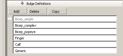

Bulge Definitions lister
The Bulge Definitions lister is another way of specifying which bulge should be applied on a joint.
Clicking an entry in the bulge lister selects that bulge and displays it in the Bulge Section Editor. To change the name of a bulge, double click in the field, type a name, then press Enter.
Bulge Definitions Buttons
Add — creates a new generic bulge with two sections of three keypoints each.
Delete — deletes the currently selected bulge type.
Copy — copies the currently selected bulge.
Caution! Bulge definitions are stored by code in the bulge_types file and referred to by code in the wire files. If a joint in the current or any other wire file refers to a bulge code that no longer exists, you will not be able to do an Attach.

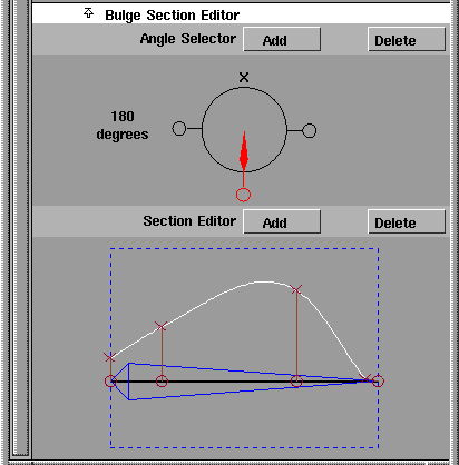

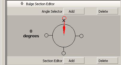

Angle Selector
The Angle Selector shows the positions of the sections of a bulge (looking at the Angle Selector is like looking down the bone).
The red pointer indicates which section around the bone is being viewed in the Section Editor. The pointer can be moved around to view different sections of the bone’s bulge definition in five degree increments by clicking and dragging with the mouse. If a section has a curve defined for it, a white “handle” is drawn at that section. This handle can be dragged around and repositioned.
When Add is selected (or is pressed), clicking in the Angle Selector adds new sections. A new section curve will be created as an interpolation of the two curves on either side of it.
When Delete is selected (or (Windows) or (Mac) is pressed), clicking in the Angle Selector removes sections.
When neither one is active, clicking in the Angle Selector repositions the pointer.
Section Editor
The Section Editor shows the bone with a profile curve.
The profile curve’s position around the bone is shown in the Angle Selector. This suggests what the bulge effects look like at different places around the bone. When the Angle Selector points to one of the bulge’s defined sections, the profile curve in the Section Editor turns white and can be modified. Otherwise, the curve is dark and represents an interpolation of the bulge’s effects at that position.
Section Editor Buttons
Add — adds new keypoints to the curve
Delete — removes existing keypoints.
When neither button is selected, keypoints can be dragged around with the mouse.

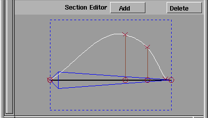

Example
There are two kinds of keypoints in the Section Editor, those represented by x and those by o:
In most cases, the bulge direction will be to be perpendicular to the bone. If the line between o and x is not perpendicular to the bone, the bulge slides along the bone as well as move away from the bone.
In the following example, this is represented in the Section Editor by keypoint A having a perpendicular dropped to the bone. If you grab the o’s along the bone and drag them with the mouse, you change the direction of the bulge. Keypoint B, for instance, will bulge somewhat along the bone axis, toward the lower end of the joint.
For example, a simple biceps bulge could contain two sections: one above the bone—at zero degrees— with the profile curve resembling a flexed biceps, and the other at 180 degrees with a flat profile curve signifying no bulge below the bone.

Follow these steps to specify bulging on the upper arm. Assume that you have already defined a bulge that has the effects you want and that you’ve called it “biceps.”
  1. Since you only want to apply bulging to one joint, choose Hierarchy Depth NONE. (In this example, joint attributes are being set only for the shoulder joint.)
  2. Click the Bulging toggle to turn bulging on.
  3. Choose Pick > Object and then pick the entire skeleton. This selects the shoulder joint of the skeleton.
    • Some attributes are very important, since they determine how a bulge will be applied to the skeleton. Zero Degree Section, Relate Transform, and Transform Range must all take into account the way your skeleton was defined: its orientation in space, which rotation bends the elbow, and which values of that rotation should result in bulging.
  4. Choose Set Attributes from the Frame Control menu. The system prompts:
    Modify joint attributes, then press GO
    A Go icon is displayed at the bottom right of the current window.
    Because you are in Set Attributes mode, any modifications you make in the Bulging Attributes or Joint Attributes sections of the window are stored on the selected joint hierarchy and will be reflected in the representation of the bulge effects displayed in the modeling windows.
  5. Select your “biceps” bulge from either the Bulge Type menu or the Bulge Definitions lister.
  6. Change the options in the Deformation Control window until you’re happy with the way the bulge looks in the modeling windows.
    Notice that even though Bulging has been turned off in the window, bulging attributes on the shoulder joint have already been set. The state of the options in the window when Attach is selected shows what attributes are used on joints in the hierarchy that don’t have attributes explicitly stored on them already.
  7. Click Go to exit the Set Attributes mode.

    The CHARACTER BUILDER Attach operation automates two tedious tasks: creating all the bending and bulging clusters and generating the expressions linking bulging clusters to transformations on a DAG node. It is important to remember:
    • Bending clusters are grouped under joint nodes in the SBD. There is one bending cluster created for each joint in the hierarchy selected during the Attach.
    • Bulging clusters are created outside the joint hierarchy. Complex bulges can generate many bulge clusters, which are created compressed in the SBD—you can uncompress them as needed.
