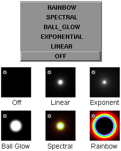

Glows
The type of glow that the light produces when viewed directly. A light without glow can illuminate objects when the scene is rendered; however, a light needs glow to be seen by the camera when the scene is rendered. You can assign glow to all types of light except ambient lights.
If Glow is set for a light, the Glow, Radial Glow Effects, and 2D Glow Noise Glow Effects parameters become available. The default setting is OFF.
OFF No glow
LINEAR Glow slowly diminishes from the center of the light
EXPONENTIAL Glow quickly diminishes from the center of the light
BALL_GLOW Glow diminishes faster towards a distance (from the light center) specified by the glow Spread value
SPECTRAL Lower wavelengths (red) refract (or spread) more than the higher frequencies (blue)
RAINBOW Simulates refraction due to water droplets in air. The glow Spread value determines the radius of the rainbow.

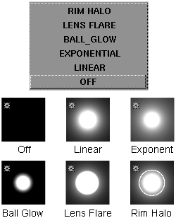

Halo
The type of halo that the light produces when viewed directly. Halo is like Glow, except that the falloff is more gradual and different falloff types are available.
The Glow Intensity value must be greater than zero for the Halo setting to have any affect. The default setting is OFF.
OFF No halo
LINEAR Halo slowly diminishes from the center of the light
EXPONENTIAL Halo quickly diminishes from the center of the light
BALL_GLOW Halo diminishes faster towards a distance (from the light center) specified by the halo Spread value
LENS FLARE Simulates a bright light source illuminating the surfaces of several camera lenses. The intensity of the flare is determined by the halo Intensity value. The size of the flare circles is relative to the field of view of the camera.
RIM HALO Forms a circular ring with a soft central glow. The size of the ring is determined by the halo Spread value.

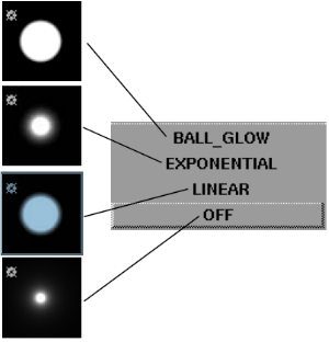

Fog
The type of fog that the light appears to be shining through. You can assign fog to point lights and spot lights to simulate light scattered from either a sphere of fog (for point lights) or a cone of fog (for spot lights). The default setting is OFF.
OFF No fog
LINEAR Fog slowly diminishes from the center of the light
EXPONENTIAL Fog quickly diminishes from the center of the light
BALL_GLOW Fog diminishes faster towards a distance (from the light center) specified by the fog Spread value
BALL_GLOW provides sharper thresholds at the edge when the fog Opacity value is non-zero. In spot lights, the Decay value determines how fast the light falls off from the center of the light. Shadows can be cast into volumes of fog by using spot lights when Shadows are set ON and the Fog type is LINEAR.
Use fog to simulate effects such as smoke or fog in the air. Light scatters diffusely and creates a radiance around light sources. This type of radiance fills a volume of space, and can show shadows of objects. Objects can immerse into the glow or stand in front of it, unlike retinal glow, which is always in front of objects. Fog glows can be visible even if the light source is totally obscured.
Use fog to simulate illuminated fog. Smoky fog can be simulated by using the 2D Noise parameters (this noise is also available for glow). The smoke can be animated by using the u and v offset parameters. Dark smoke can be specified by using the opacity parameter and making the color of the light black or negative.

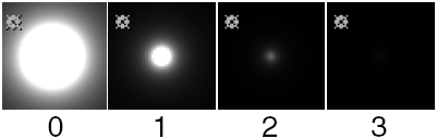

Decay
Controls how quickly light intensity decreases with distance. The Decay setting has no effect at distances less than 1 unit.
The Decay parameter works differently for volume lights (see Decay). Valid settings are 0, 1, 2 or 3. The default setting is 1.
0 no decay; light reaches everything
1 light intensity decreases directly (linearly) with distance (slower than real world light)
2 light intensity decreases proportionally with the square of distance (the same as real world light)
3 light intensity decreases proportionally with the cube of distance (faster than real world light)

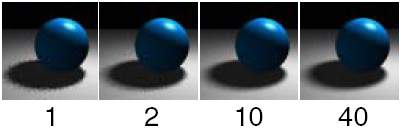

Shadow Samples
The minimum number of shadow feeler rays per sample (used to create raytracer soft shadows). A large Shadow Samples value increases rendering times but produces smoother soft shadows. The valid range is 0 to 100. The slider range is 1 to 40. The default value is 2.

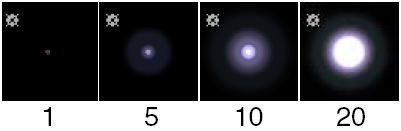

The color of the light’s glow. The default setting is white.

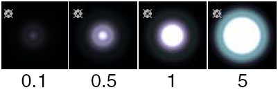

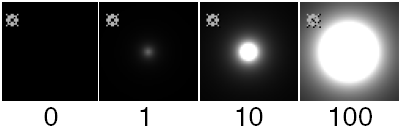

Intensity

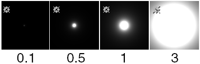

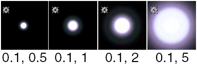

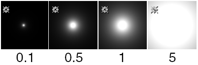

The brightness of the glow. As the Intensity value increases, so does the apparent size of the glow effect. A negative Intensity value subtracts from other glows. (The Decay value controls how the glow brightness decreases with distance.) The slider range is 0 to 5. The default value is 1.

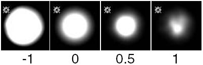

Spread
Controls the size of the glow effect. Negative values can have odd but useful effects. The slider range is 0 to 5. The default value is 1.

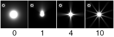

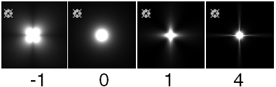

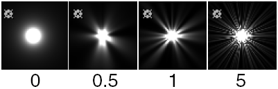

Star Level
Simulates camera star filter effects. The slider range is 0 to 4. The default value is 0.

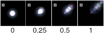

Use the Star Points parameter to set the number of points on the star. Use the Rotation parameter to rotate the star.

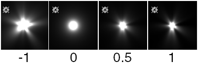

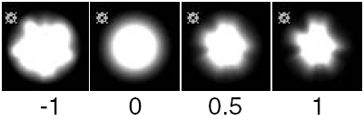

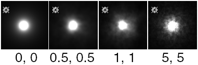

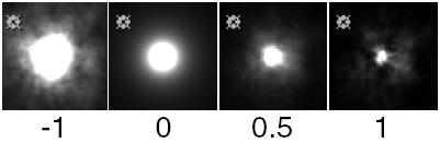

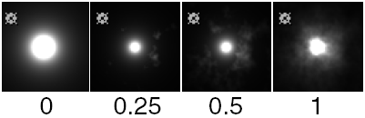

Radial Noise
Randomizes the spread of the glow to simulate starburst effects and eyelashes refracting light. The slider range is 0 to 1. The default value is 0.
Negative values of Radial Noise produce thicker noise. Use the Noise Freq. parameter (under Radial Glow Effects) to control the smoothness of this effect.

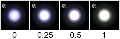

2D Noise
The strength of two-dimensional noise applied to the glow. The noise is generated on a plane that is centered at the location of the light and always oriented towards the camera. The slider range is 0 to 1. The default value is 0.
To create the illusion of illuminated smoke around a glowing light source, set the 2D Noise value to about 0.5 and slowly animate the Uoffset and Voffset values. The smoke will appear to slowly drift by the light.
Generally fog illumination (2D Noise under Fog Illumination) is better than glow for creating smoke and fire effects, because fog is a 3D effect (for example, glow 2D noise cannot be occluded by objects).

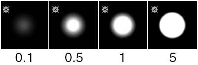

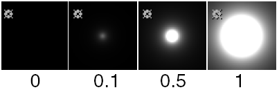

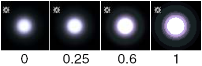

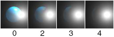

Opacity
The amount that the light’s glow obscures objects behind it. Opacity can be thought of as the opposite of transparency. The slider range is 0 to 0.5. The default value is 0.

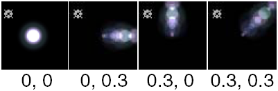

Vertical, Horizontal
Controls the axis of the flare effect relative to the center of the image. If the light source moves, the flare appears to rotate through this point. The slider range is -1 to 1. The default value is 0.

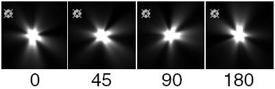

Rotation
Rotates glow and fog noise and star effects (2D Noise, Radial Noise, and Star Level) about the center of the light. The slider range is 0 to 360 (degrees). The default value is 0.
Star Points
The number of points on glow star filter effects. A Star Points value of 1 produces a comet-like effect. A non-integer Star Points value could render with a seam or hard line at the top of a star effect. The slider range is 0 to 10. The default value is 4.

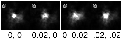

Uscale, Vscale
Scales glow and fog 2D noise in the horizontal (Uscale) and vertical (Vscale) directions. The slider range is 0 to 5. The default value is 1.
Tip:
You can use Uscale and Vscale to create layered fog or tall flames. Animate the Uscale and Vscale values from high to low values to make the noise appear to fly apart like an explosion.
Uoffset, Voffset
Offsets glow and fog 2D noise in the horizontal (Uoffset) and vertical (Voffset) directions. For example, you can animate the Uoffset and Voffset values to simulate smoke, rain, or snow moving past a light. Noise repeats after an offset of 1. The slider range is 0 to 1. The default value is 0.
