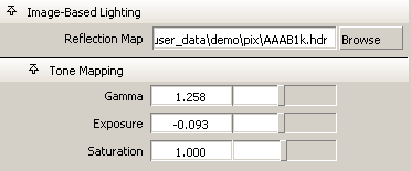

Image-Based Lighting
Reflection Map
Either type the full or relative path to the High Dynamic Range (HDR) image to be used as a reflection map or click the Browse button to navigate to the file. HDR images are the only type of image allowed to be used as reflection maps for Image-Based Lighting.
HDR images can be created using Photoshop CS2, HDRIshop, or purchased; some are available on the web, as well (search for “royalty-free HDR images”).
Tone Mapping
The contribution of image-based lighting to illuminating the model can be controlled by tone mapping. HDR images, since they have a wide range, may produce a resulting rendered image that may need to be "toned" to represent lighting that is suitable for the scene. The toning is applied near the end of the rendering process, and the final rendering accounts for both the toned image-based lighting and the rendering done with regular lights. The tone mapping does not affect regular lights.
As with digital photography and images that are higher than 24 bits, the longer the original data is maintained and the later in the process that it is reduced to 24 bits, the more value the high dynamic range data can contribute to the final image.
Gamma
Sets the brightness of the mid-tone values of the reflection map. Lower values create darker reflections; higher values create brighter reflections.
Exposure
Sets the overall brightness of the reflection map. Lower values reduce the exposure of the image; higher values increase the exposure compensation.
Saturation
Sets the amount of color in the reflection map that will be used.

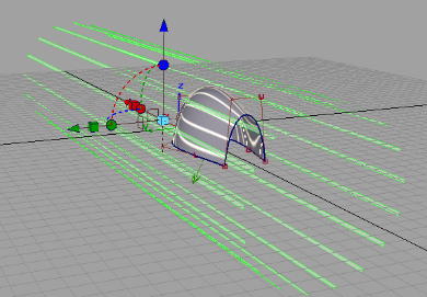

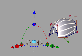

A new visualization tool enables you to see your model as if it were surrounded by long fluorescent light fixtures. The linear reflection tool is only available in hardware shade mode.
How to create linear reflections
  1. Open WindowDisplay > Hardware Shade and check that the shading mode is set to Per Pixel.
  2. To interactively create linear reflections, turn on Linear Reflection, choose Shade On and close the window.
  3. Choose the Hardware (per pixel) tab on the Environment editor. Scroll down to Linear Reflection Controls.
  4. Adjust the Environment settings to suit your model. The reflections don’t add lights to the scene, just reflections to the model that look like they were generated from a series of fluorescent light tubes.
Linear Reflection controls
Show Tunnel
If turned on, the tunnel is represented with green lines. It’s useful to turn the display on when creating the reflection band display.
Color
Click the swatch to choose a color other than white for the reflections, or move the slider to change the value of the color.
Intensity
Controls the relative brightness of the reflections. Values greater than one are equivalent to setting a light to the same intensity.
Number of Bands
Controls the number of bands of reflected light in the cylinder.
Band Width
Controls the width of the lights.
Band Fringe
Controls the edge transition of the lights ranging from a hard, sharp transition to a smooth soft transition.
