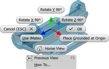

Place Component
A new assembly application option specifies whether to ground the first placed component at the origin. This new option is turned off by default. To ground any component at the origin, use the context menu. The menu contains new options to rotate components in 90-degree increments about the X, Y, or Z axis, before you place them in the assembly.

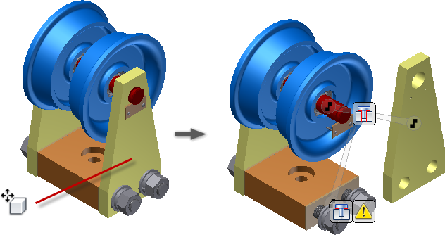

Free Move
With the Free Move command, display relationships as an elastic band, and visualize and manage relationships in a new way. Click a relationship icon, and then, to suppress, unsuppress, or delete relationships, use the context menu.

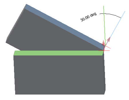

Improvements in Angular constraints
When you create an angular constraint, the status bar displays clear instructions to finish the Constrain command.
Angular constraints display direction vectors and the angle in the graphics window.
The model preview updates when the Angle value changes.

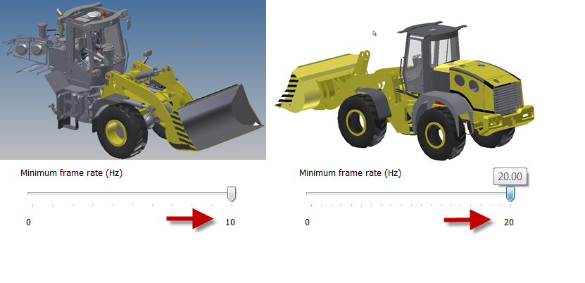

Improved graphics performance
The following graphics enhancements improve the performance of pan, zoom, and rotate of large models in both Full and Express mode.
  • The maximum frame rate is increased from 10 Hz to 20 Hz.
  • The largest objects are drawn first.
  • The graphics system now uses multiple cores to provide the best possible performance.
  • A new background operation called consolidation is added. Consolidation draws objects that have the same appearance as a single group, improving the GPU usage.
In the following images, the 2013 model on the left displays the results of rotating the model using the maximum of ten frames per second. Increasing the frame rate increases the speed, but the choice of components to draw is not intelligent. The 2014 model on the right shows the results of rotating at the faster maximum frame rate of 20 Hz. The model remains recognizable, and all view operations are faster.

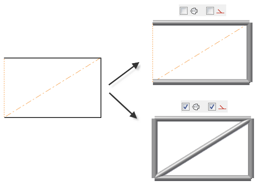

Enhancements in Insert Frame command
In previous versions of Inventor, construction lines and center lines are automatically included, and frame components are created from them.
In the current version, you can exclude construction lines or center lines from the geometry selection used to create frame components.
On the ribbon, click Design tab Frame panel Insert Frame . Then, in the Insert dialog box, select or clear the Select Centerline, or Select Construction options to specify your settings.

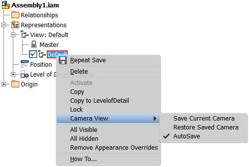

Camera setting in view representations
In previous versions of Inventor, the camera position is always automatically saved on closing the design view representation. When you rotate or zoom the model in a design view, tools to restore the previous camera settings are limited.
With new commands in the view representation context menu, you can easily save and restore the camera settings.
For More Information

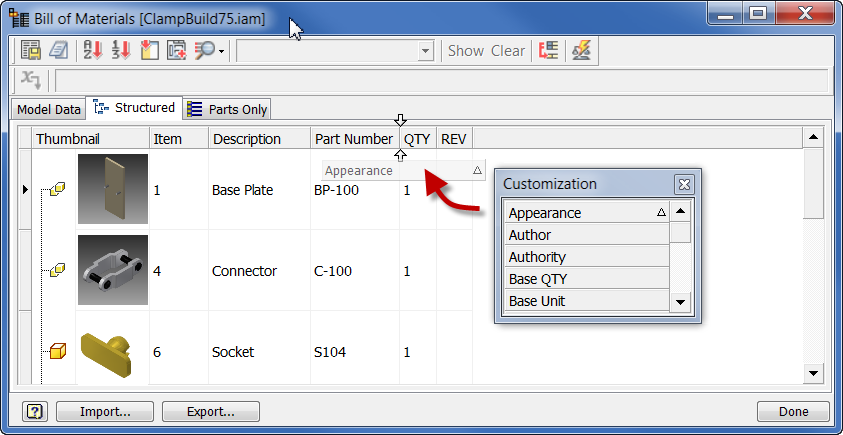

Appearance property
The model Appearance value is added as a selectable property. You can add the Appearance property to a bill of materials or a parts list.
