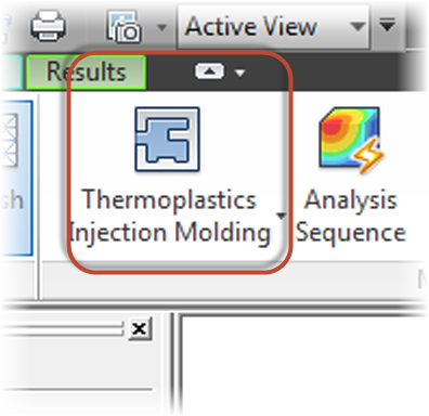

  1. Click Home > Molding Process Setup > Thermoplastics Injection Molding to see the other molding processes that are available. Keep Thermoplastics Injection Molding as the molding process.

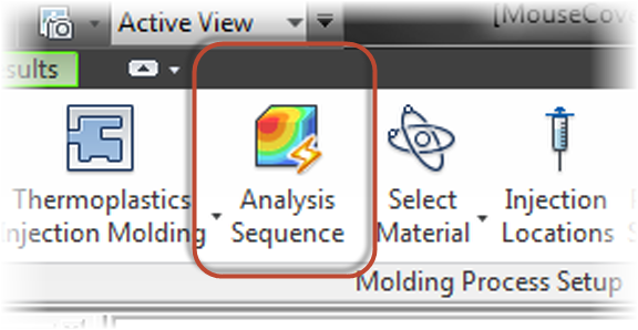

  2. Click Home > Molding Process Setup > Analysis Sequence to see the analysis sequences that are available. Ensure that the analysis sequence is Fill.

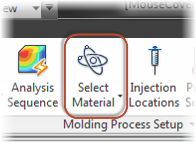

  3. Click Home > Molding Process Setup > Select Material.

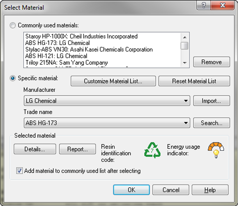

  4. Select LG Chemical as the Manufacturer.
  5. Select ABS HG-173 as the Trade Name.
