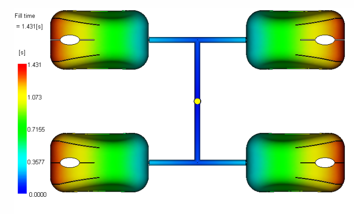

Review Fill Time Results
In this task, you interpret the fill time results.
  1. Click Home > Results > Results.
  2. Click Fill time in the study tasks list.
  3. Click Play.
  4. Rotate, pan, and zoom as necessary to see the filling pattern.
The filling pattern is uniform between the 4-parts.
