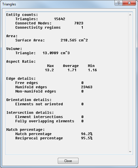

  2. Click Show on the Mesh Statistics panel to display the Mesh Statistics dialog box.
    The only problem indicated is the Maximum aspect ratio is a bit high. It should be under 6:1, although the current value is not too bad.

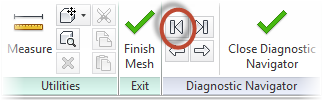

  4. Click (Mesh tab > Diagnostic Navigator panel > Start) to find the element with the highest aspect ratio. It has a red line coming out of it. Rotate the part to find the element if necessary.
