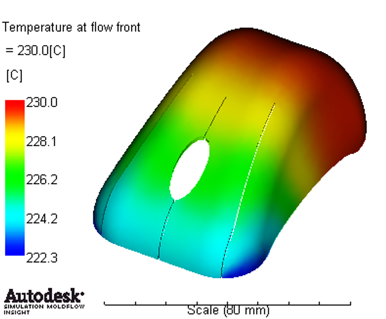

View Temperature Results
In this step, review the Temperature at flow front results.
  1. Click Temperature at flow front in the Study Tasks list.
  2. Rotate, Pan, and Zoom the model as necessary to inspect the fill time result.
  3. Click Results > Animation > Play to animate the result. Use the other animation tools to see what they do.
  4. Rotate the part similar to the plot.
  5. Click Results > Plots > Examine to show the value at a specific location on the part. Use the CTRL key when clicking the part to select more than one location.
