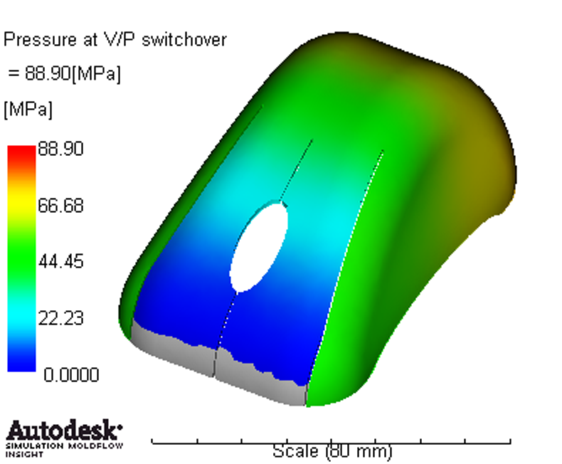

View Pressure Results
In this step, you review the Pressure at the Velocity / Pressure switch over results.
  1. Click Pressure at V/P switchover in the Study Tasks list.
  2. Rotate, Pan, and Zoom the model as necessary to inspect the fill time result.
  3. Click Results > Animation > Play to animate the result. Use the other animation tools to see what they do.
  4. Rotate the part similar to the plot.
  5. Click Results > Plots > Examine to show the value at a specific location on the part. Use the CTRL key when clicking the part to select more than one location.
