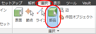

1. From the ribbon, click Selection (tab) > Select (panel) > Parts.

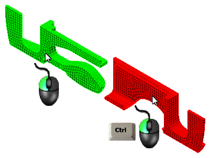

2. Select the first part, hold Ctrl, and select the other.

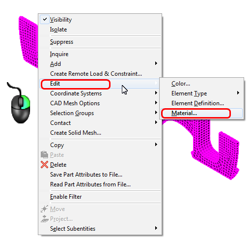

3. Right-click in the display area, and select Edit > Material.

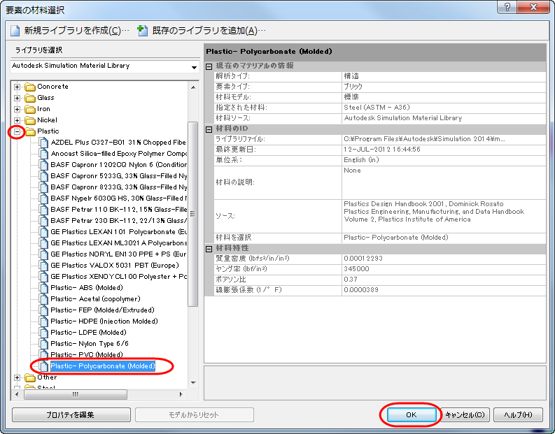

4. Expand the Plastic branch, and select Plastic-Polycarbonate (Molded). Click OK.
5. When asked to confirm, click Yes.
