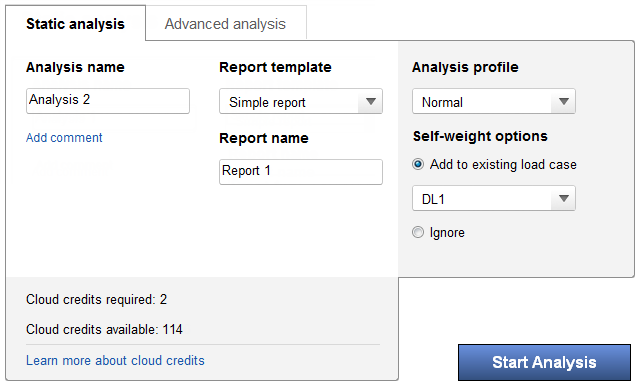

    The New Analysis page opens where you can define parameters of the analysis.
  3. Define static analysis parameters.
    Note: To learn more about definition of parameters, see Performing the Analysis.
  4. Click Start Analysis.
