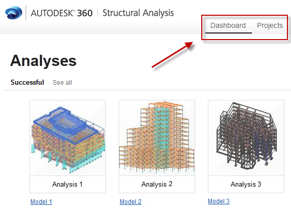

The Autodesk® 360 Structural Analysis website consists of the following tabs.
Dashboard tab
The Autodesk® 360 Structural Analysis website opens by default on the Dashboard tab. Here you can view the recently performed analyses (Successful, In Progress and Failed).
Position the cursor on the image of an analyzed model to display additional information such as a project name and parameters of the analysis.
