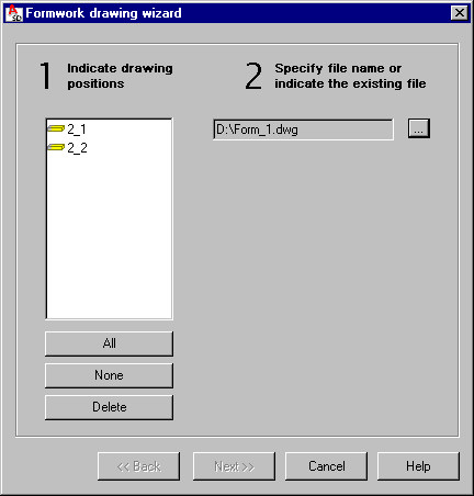

Formwork drawing wizard
Use the wizard to save formwork drawings or to transfer them to Autodesk AutoCAD Structural Detailing - Reinforcement. You can also automatically generate reinforcement for selected structure elements. The contents of the Formwork drawing wizard dialog depend on the context menu option selected on the Positions tab of the Object Inspector dialog.
The dialog displays when you:
Export formwork drawings to Autodesk AutoCAD Structural Detailing - Reinforcement
Export formwork drawings to a DWG format file
Automatically generate reinforcement using Autodesk AutoCAD Structural Detailing - Reinforcement macros.
