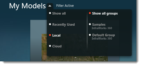

Filter Models
Filter the display of model tiles using My Models. If you don't see a tile for a model, check your filter settings on the drop-down menu. Models can be filtered by status (Recently Used, Local, Cloud) or by Design Group. See InfraWorks Home for more about model status.
