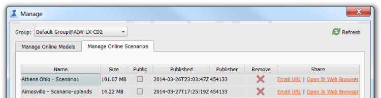

Manage scenarios you have already published to the cloud. View the name, size and latest publication/sync date of each scenario. You can remove a scenario from its shared model, open a scenario in the Web Viewer, or email an invitation to a stakeholder to view the scenario using the InfraWorks 360 iPad app.
Publically available scenarios are checkmarked.
From InfraWorks Home:
- Click
to display a horizontal menu.
- Click
to open the Manage panel, then click the Manage On-line Scenarios tab.
- Display the correct design group, if you belong to more than one.
- Click X to Remove the on-line version of a scenario from its model.
Local copies are unchanged. The scenario definition in the model remains.
- Click Email URL to share a scenario by invitation to a stakeholder. Invited viewers who are not InfraWorks 360 users need the InfraWorks 360 iPad app.
- Click Open In Web Browser to view the scenario on your computer.
- If Public is checkmarked, anyone with the InfraWorks 360 iPad app can view the scenario.
Note: You can not make a scenario public from this panel. Use the Scenario Editor asset card to change publication rights.
The panel is a static list. To display recent changes, click Refresh if the panel has been open for a while.
