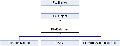

Inheritance diagram for FbxDeformer:Multi-Layer Flag | |
