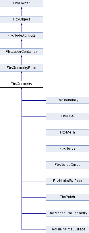

This reference page is linked to from the following overview topics: #include <fbxgeometry.h>
The base class of geometric objects that support control point deformations (e.g.
FbxMesh, FbxNurbs, and FbxPatch). The FbxGeometry provides support for the following kinds of deformations.
Most of the methods of FbxGeometry are wrappers to simplify the access/manipulation of the connections to the deformers. For example, calling the GetDeformerCount() method is the same thing as calling:
Examples: Definition at line 45 of file fbxgeometry.h.
Inheritance diagram for FbxGeometry:Public Types | |
