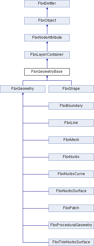

+ Inheritance diagram for FbxGeometryBase:
