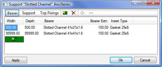

Bearer Tab
Width/Depth - Value entries which establish the number of breakpoints to be used across the three tabs. Adding an entry (row) here applies across all tabs. In terms of the application, a 500x500 breakpoint will apply to all sizes up to and including 500x500. Above this value of 501x501 uses the next breakpoint indicated in the example as 99999x99999. Multiple entries can be created to determine changes in the support options.
Bearer - This is for Ancillary Material assignment. A Material must be assigned with the correct costing parameter (per m value) in order for this to be displayed in the Cost Breakdown. The length of the Bearer is dictated by the type selected but commonly the width of the item if Rectangular/Oval or the circumference if using Round/Pipe.

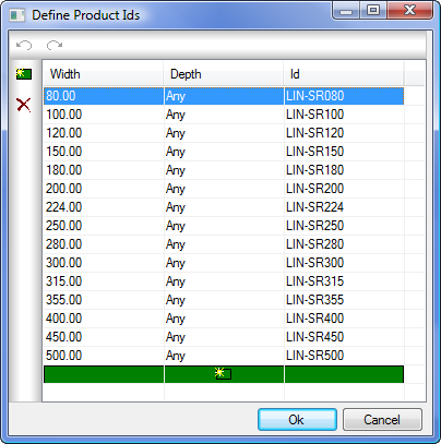

For product listed supports, the ancillary material can have a code based reference for each size by using the Product Ids option on the Ancillary Material creation dialogue.
When defining the sizes and codes from the Product Ids option, the Product Id field on the Ancillary Material will automatically display a Breakpoints value to show that this has breakpoints assigned.
The code for each diameter can be linked to a code based price list which must be costed per m for each of the sizes for example to enable calculation for circumference length.
Bearer Extn - The Bearer Extn field is a custom value extension that is added to the total length of the bearer. Commonly used to accommodate for the Rod fixings and is dependant on the type of Support being costed.
Insert Type - Provides the ability to assign additional material to the underside of the item and acts as the material between item and bearer. This is created in the Ancillary Materials section and assigned using the drop down box. Whether this is used is dependant on the Support type again but commonly the insert can be priced per m. Example would be the Width of the duct for Rectangular/Oval or Circumference/2 if Round/Pipe.

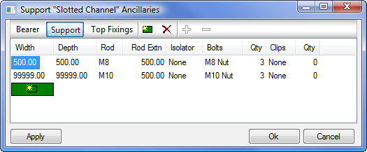

Support Tab
Width/Depth - Value entry which establishes the number of breakpoints to be used across the three tabs. Adding an entry (row) here applies across all tabs. In terms of the application, a 500x500 breakpoint will apply to all sizes upto and including 500x500. Above this value of 501x501 uses the next breakpoint indicated in the example as 99999x99999.
Rod - The Assignment of a Support Rod Ancillary. Support Rod Ancillary must be created from the Ancillaries database. If using Profile Bearer type, this is a length based output initially from the depth of the item being supported. For Example a 600x400 rectangular duct would have a default Rod length of 400mm. A 250 diameter pipe would have a default 250mm Support Rod allocated.
Rod Extn - Is the additional length of Rod required to be added to the Rod length. Item Depth + Rod Extn = Total length of Rod. Multiple rods will get extensions for each. Again, this is dicated by the type of support selected as to whether its applied.
Isolator - Created from the Support Isolators Ancillary. A cost per Quantity can be assigned per Rod application.
Bolts/Qty - Ancillary Fixings can be assigned and specified a quantity for application onto the Support cost.
Clips/Qty - Can specify additional Ancillary Fixings for Clips.

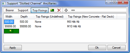

Top Fixings Tab
Width/Depth - Value entries which establish the number of breakpoints to be used across the three tabs. Adding an entry (row) here applies across all tabs. In terms of the application a 500x500 breakpoint will apply to all sizes upto and including 500x500. Above this value of 501x501 uses the next breakpoint indicated in the example as 99999x99999.
Top Fixings (Undefined)/Alternative - If using Top Fixings, the default would be undefined which uses the Fixing ancillary listed in the drop down for that column.
Multiple Fixing types can be created from the Ancillaries database > Fixings.
Different types of fixing can be defined for different structures that the supports will be fixed to. The Plus icon from the top menu adds a new type in which you can select an alternative Fixing type from the available structures. The Minus icon provides a list of any existing structures used for deletion.
The Structures are setup in the Structure Types section of the Services Database. Each service can be set to use a particular Structure type at Takeoff.
Each type is listed here with which ancillaries report out when they are assigned tot he breakpoint fields.
