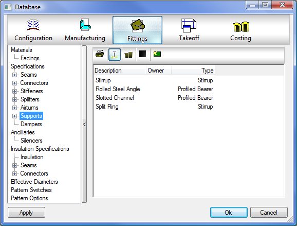

To amend or setup Supports navigate to your Database. Please use the Navigation & Toolbars for information on how to access the Global database using your application.
Under the Fittings section, select the Supports link visible as a sub category of Specifications.
There are two sections to the supports dialogue. Manufacturing and Estimating which are accessed through the top toolbar.
Supports Toolbar
Gives a full print of the current support configuration and assignments.
The default is the manufacturing view. This lists all the supports in the database and their types allocated.
Provides the ability to assign a Labor rate for costing against any fabrication or Installation time of the support ancillaries.
Filter out Non User Data, allows the filtering of MAPs content from the view.
Creates a new support type. If an existing support is highlighted when pressing this icon, there will be a prompt to copy the existing supports values.

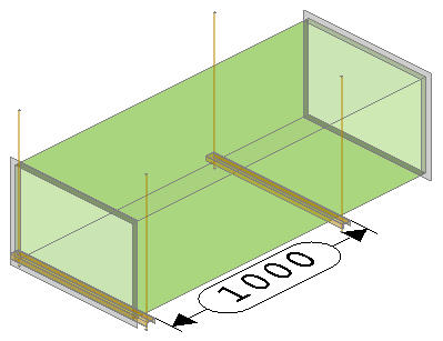

Using item Specification, you can assign the type of support against each breakpoint size and additionally enter a spacing value for each instance. The diagram of the Rectangular Straight piece dictates how the spacings are calculated. The first support is always at the zero length and then based on the length entered, additionally added for each spacing value. The example shows a 1000mm spacing on a 1500mm duct length therefore 2 supports will be included into the Straight Rate.

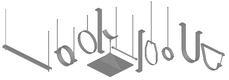

The support item file CID 838, has a number of support options which cycles through the varying styles for drawing. Some of the styles can be seen at the bottom of this help topic in a 3D view.
