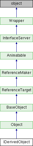

+ Inheritance diagram for IDerivedObject:
