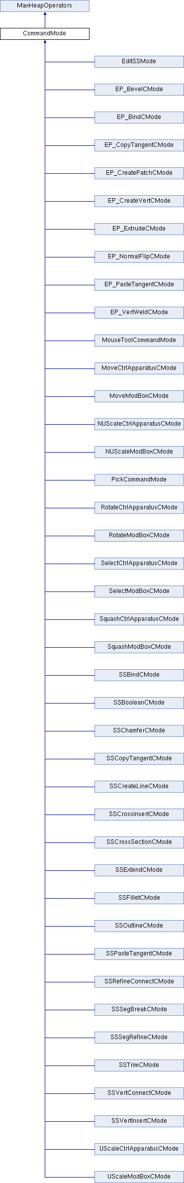

Inheritance diagram for CommandMode:Public Member Functions | |
