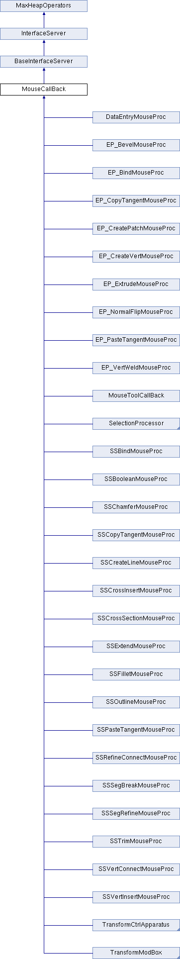

Inheritance diagram for MouseCallBack:Public Member Functions | |
