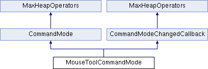

+ Inheritance diagram for MouseToolCommandMode:
