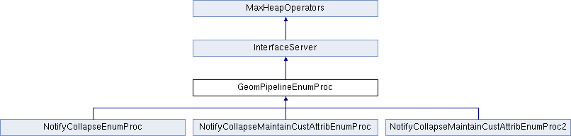

+ Inheritance diagram for GeomPipelineEnumProc:
