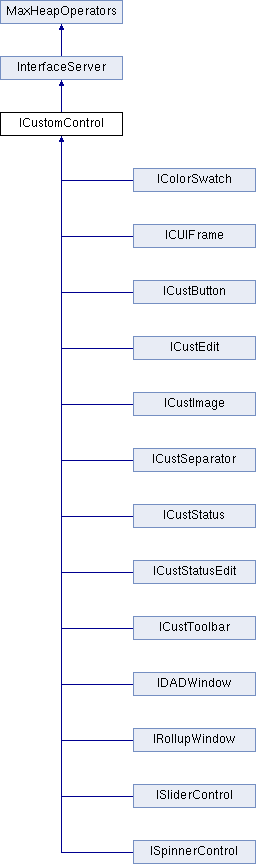

+ Inheritance diagram for ICustomControl:
