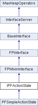

+ Inheritance diagram for IPFActionState:
