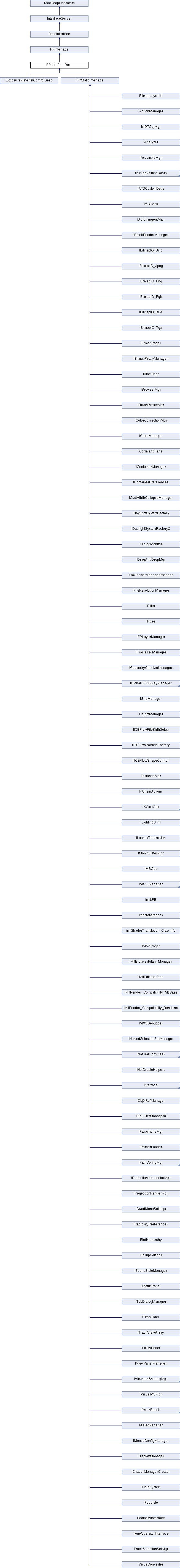

+ Inheritance diagram for FPInterfaceDesc:
