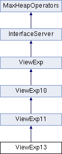

Extends ViewExp11.
The following code example shows how to get access to this interface:
Inheritance diagram for ViewExp13:Public Member Functions | |
