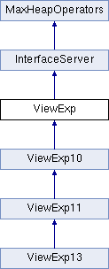

+ Inheritance diagram for ViewExp:

- Public Member Functions inherited from InterfaceServer
virtual UtilExport ~InterfaceServer ()
 Destructor. More...
virtual UtilExport BaseInterfaceGetInterface (Interface_ID id)
Additional Inherited Members
