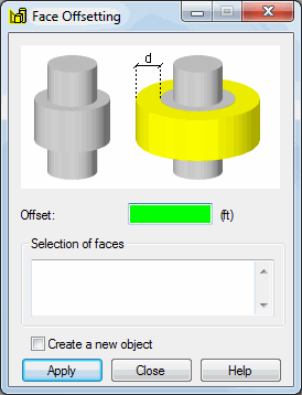

The option changes the position of object faces (offsetting). Using this option results in offsetting the entire face surface by the specified distance with respect to the initial face position. The diagram in the dialog shows how the offsetting operation is performed.

  1. In the Offset field enter a distance (offset), by which to offset the face. A negative offset value causes offsetting towards the inside of an object.
  2. Select the faces (edges) to be offset.
  3. Click Apply.
If the Create a new object option is selected, the resultant object is assigned a new number.
