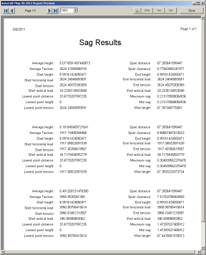

To Prepare Analysis Reports
You can prepare reports for the results of each analysis. Reports can be HTML, text, and PDF format. You can print or save the reports.
  1. Open the Analysis palette in the Dashboard.
  2. Expand the details for the analysis operation of interest.
  3. Expand the Results section.
  4. Click View Report .
  5. In the Select Report dialog box, select a report template and click OK.
  6. In the Report Preview window, click HTML, text, or PDF for the desired format.
    You can print or save the report.
