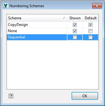

  2. Click the Master Menu on the toolbar and select Numbering Schemes to open the Numbering Schemes dialog.
  3. Select the Shown check box for any numbering scheme you want to display as a view button in the Numbering Schemes Panel.
  4. Select the Default check box to set a Numbering Scheme as the default setting.
  5. Click OK.
