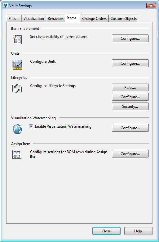

Learn about items administration for Vault 2015 and Vault 2015 R2.
The Items tab contains options for configuring item behavior.
Item Enablement
Enable or disable the Items feature to better control user access.
Units of Measurement
Define and edit units of measurement for items.
Lifecycles and Revisions
Rules for bumping the revision can be specified as well as the default revision sequence to use. New revision sequences can also be defined. Automatic file locking can also be enforced on the Items tab.
Watermarking
Item watermarks can automatically be generated based on an item's lifecycle state, a specified item property, or customized text. In addition, administrators can configure the watermark style and position.
Assign Item
Configure whether BOM rows are automatically turned on or not during item assignment.

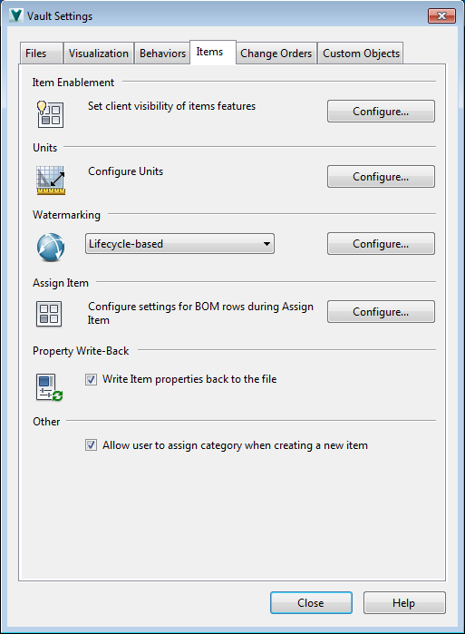

Item Enablement
Watermarking
The Watermark value is based on the current lifecycle state of the item.
To select a new lifecycle, make sure Lifecycle-based is selected in the drop-down menu and click Configure.
The Watermark value is based on a specific item property you have identified on the Property-based Watermark Settings dialog.
To select a new item property for the watermark value, make sure Property-based is selected in the drop-down menu and click Configure.
The Watermark value comes from a value you enter on the Custom Watermark Settings dialog.
To select a new custom value for the watermark, make sure Custom is selected in the drop-down menu and click Configure.
No Watermark is applied to items.
Assign Item
Property Write-Back
By default, item properties are written back to the associated file from Vault add-ins, Vault Explorer, and the Job Processor.
Item properties take precedence over file properties and file mappings. If the file's properties are edited and properties are synchronized, the item properties will overwrite the file properties.
Other
Determine whether or not a user is able to assign a category to an item when the item is created. By default, this option is selected.
