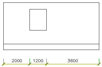

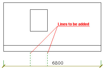

Add division point |
Use this option to modify dimension lines created by the program by defining additional points (auxiliary lines) to which a given dimension will refer. Dimensions displayed on the dimension line will be recalculated and adjusted to the location of a new point on the dimension line (see the drawing below). Before adding a line ![]() After adding a line ![]() Menu: Formwork Drawings > Dimension lines > Add division point Ribbon: ASD - Drawings > Edit drawings > Add division point Toolbar: Labels and dimensions > Add division point Command line: RBCX_DIM_UTIL_ADD |

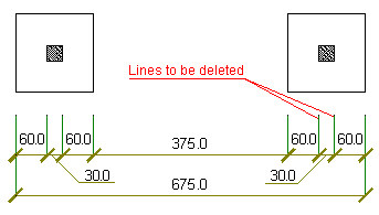

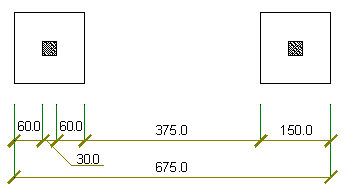

Delete division point |
Use this option to modify dimension lines created by the software by deleting indicated points (auxiliary lines) on a dimension line. After a point (auxiliary line) is deleted from a dimension line, dimensions on the line will be recalculated (see the drawing below). Before deleting a line ![]() After deleting a line ![]() Menu: Formwork Drawings > Dimension lines > Delete division point Ribbon: ASD - Drawings > Edit drawings > Delete division point Toolbar: Labels and dimensions > Delete division point Command line: RBCX_DIM_UTIL_DEL |
