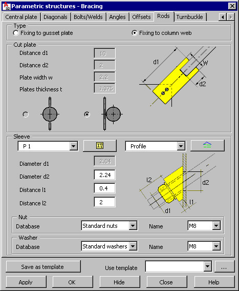

The Rods tab
For type, select either Fixing to gusset plate or Fixing to column web.
Define parameters for a connection by means of cut tubes (see the drawing below):
o Distance (plate length) d1
o Distance d2
o Plate width w
o Plate thickness t - this value is the same as that for gusset plates
o Position of a rod with respect to the plate
- Fixing to column web
Define the profile and family:
- Profiles available on the selection list are those defined in the Profile List dialog. To add a profile to the list, click
. The Profile list dialog displays, where you can select a profile.
- Profile families available on the selection list are those defined in the Family Manager dialog. To add a family to the list, click
. The Family manager dialog displays, where you can select a family.
Define sleeve parameters:
- Diameters: d1 and d2
- Distances l1 and l2
- Parameters of a nut and a washer

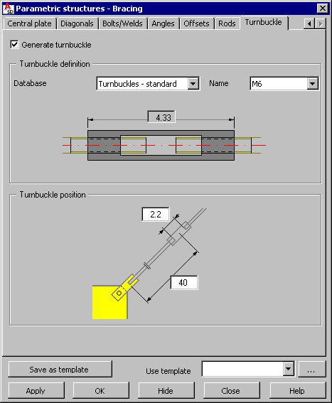

The Turnbuckle tab
If Generate turnbuckle is not selected, a turnbuckle will not be generated. In order to generate a turnbuckle and define parameters of a connection, select Generate turnbuckle.
Specify turnbuckle parameters:
- Database
- Name (type)
- Position (dimensions that determine a position of a turnbuckle)
