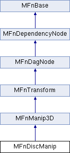

Inheritance diagram for MFnDiscManip:Public Member Functions | |
