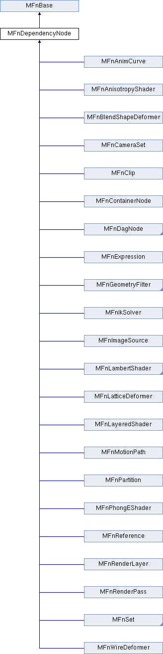

+ Inheritance diagram for MFnDependencyNode:
