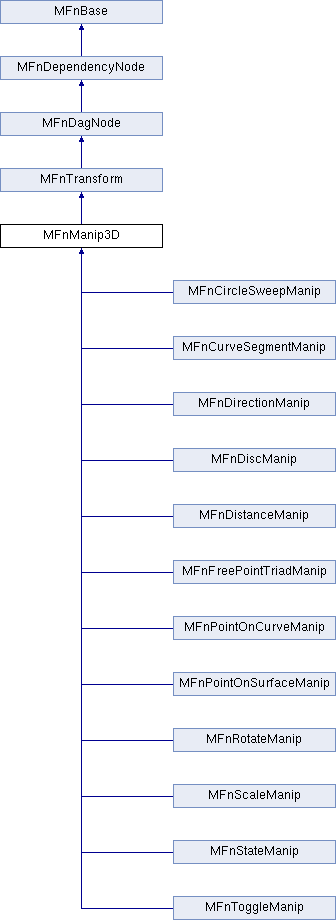

3D manipulator function set
MFnManip3D allows the creation and manipulation of 3D manipulators. MFnManip3D is the base class from which MFnFreePointTriadManip, MFnDirectionManip, MFnDistanceManip, MFnPointOnCurveManip, MFnPointOnSurfaceManip, MFnDiscManip, MFnCircleSweepManip, MFnToggleManip, MFnStateManip, and MFnCurveSegmentManip are derived.
+ Inheritance diagram for MFnManip3D:
