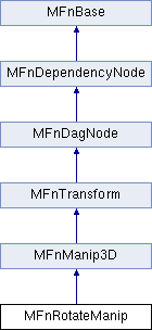

+ Inheritance diagram for MFnRotateManip:
